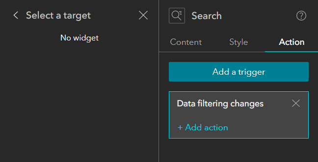

Hi,
I want to create a 'Data filtering changes' trigger on my search widget, but it says 'No widget' when trying to select a target? I'm currently working in Experience Builder (Developer Edition) V1.9. Does somebody know how to fix this issue? Thanks in advance.

Hi @VictoriaJadot ,
The message action Data filtering changes only supports targeting on map widgets. You need to add a map widget first to see it displayed in the message action target list.
Doc can be found at: https://doc.arcgis.com/en/experience-builder/latest/configure-widgets/action-triggers.htm#GUID-FF0BB...

Hi @ShengdiZhang ,
Thank you for your reply! Even with a map widget added, I still cannot see it in the message action target list.

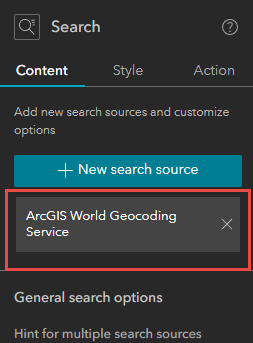

Do you have any search sources configured in the search widget?
VictoriaJadot
I'm currently using two Layer sources as search source. I suppose this is the problem; the data filtering changes trigger doesn't work with just Layer sources?
ShengdiZhang
The data filtering changes trigger should work for both layer and locator sources. I was unable to reproduce your issue in either AGOL or the dev edition 1.9. Would you mind contacting Esri Technical Support to see if they can build a reproducible environment? Thanks.
