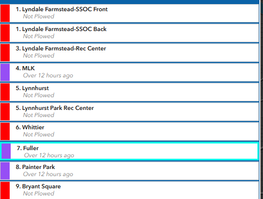

I have a button in the list widget that changes color based upon a field value.  When I click on a feature in the map and edit a value, the color changes on the map, but the dynamically styled button doesn't change in the list until I refresh the browser.  I have auto updates on the data source for the list and that still makes no difference.  Even after 15 minutes of editing the value, the color hasn't changed in the list....Screenshot 2026-03-13 092539.png

I believe I have figured out my issue.  I will mark this as solved.  I actually had to in the webmap, change the setting for the layer to refresh every so often.  Even though I had the list auto refresh, that didn't work by itself.
