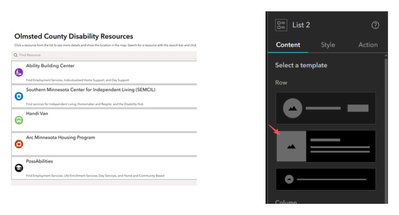

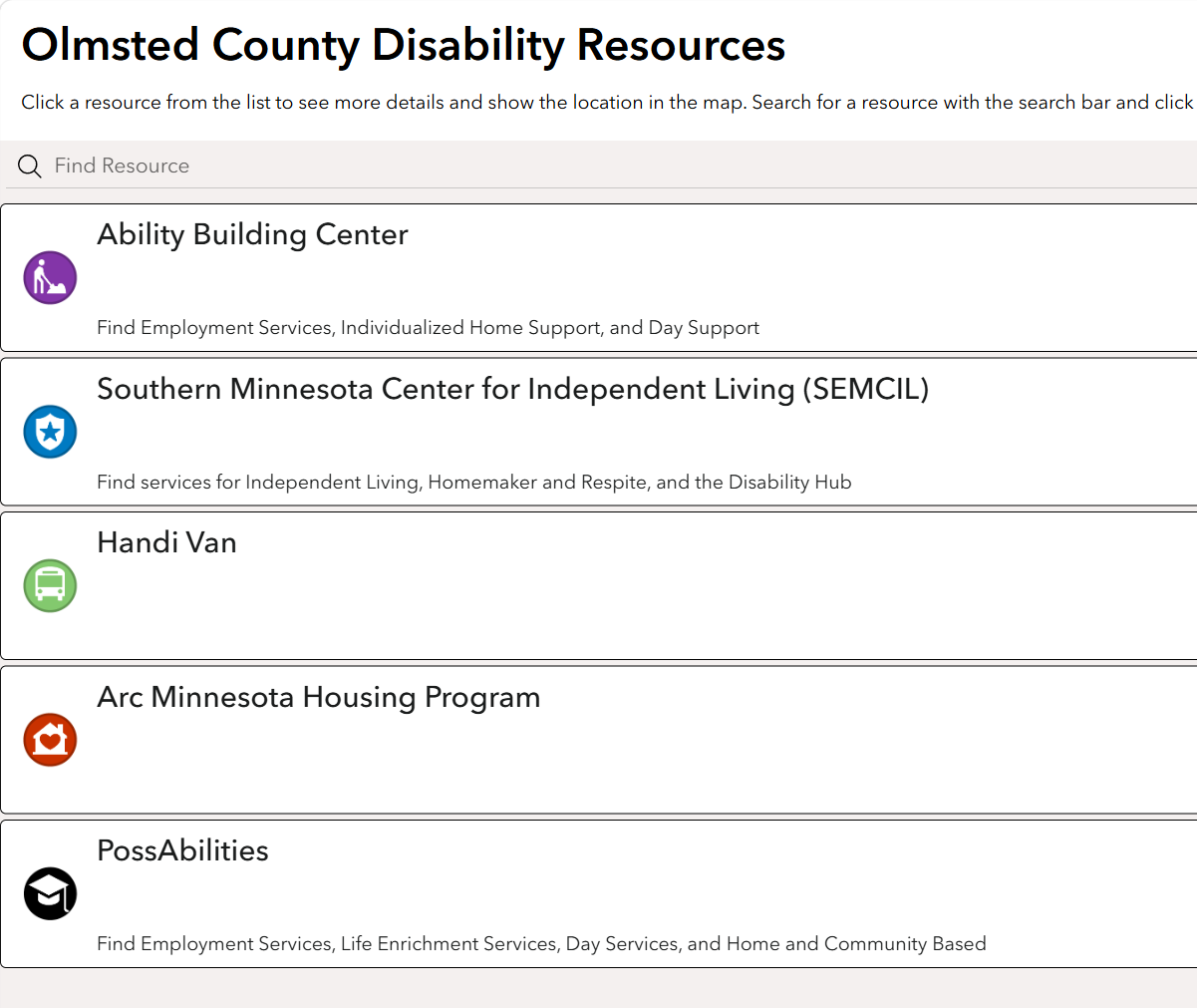

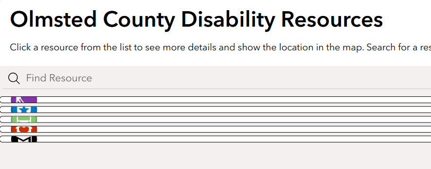

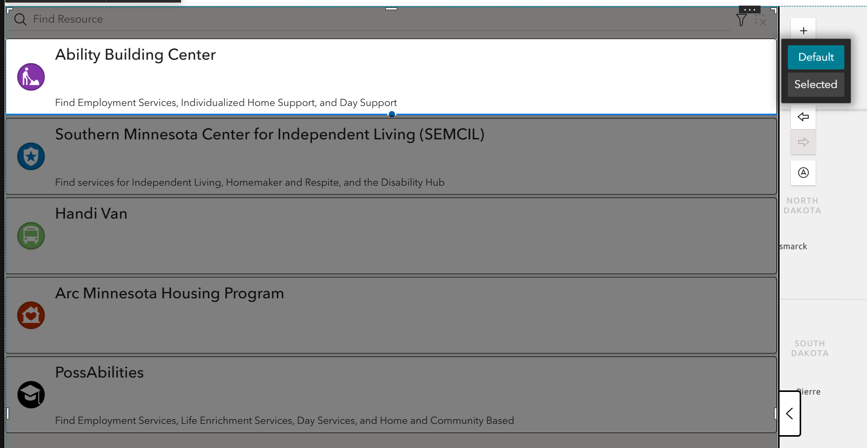

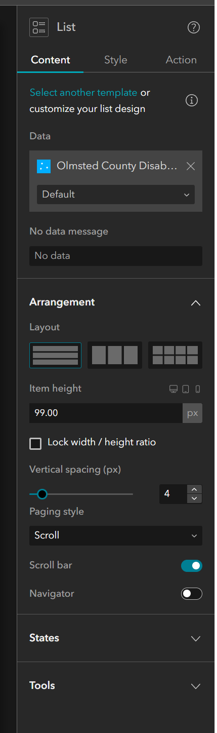

I for the life of me, cannot get this list to size appropriately. I get it sized for desktop but then it just becomes shrunk again for smaller windows/mobile/tablet. Then I make it big again and it's tiny. I've done Lists before and the settings are identical to other Lists and they are not acting like this. This is a new ExB in ArcGIS Online that I just started today. I don't want to do custom for each layout at least just yet. I just don't get what is causing it to scrunch! 😭
In the Browser (minimized screen and then full screen)
Then I refresh browser (full screen) ✔️
In the designer for desktop ✔️
In the designer for mobile/tablet
Settings (i've tried stetch, custom size etc etc, lock height/width, different arrangements, setting text and symbol to percent/auto/stretch/pixel)
This is the general layout:

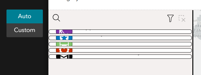

Yeah, even after I cleared the browser cache. App is not public of course. Today only the designer is behaving this way and browser visualizes it fine. So then I am forced to turn off auto. If I turn it off auto... and then customize the sizes, then it changes in the designer. I don't get it.

What's weird too is that "Auto" is supposed to set that size for all three right? Then I change it to custom and change it.... then turn it back to auto and then it's fine... So it's like Auto isn't actually working.

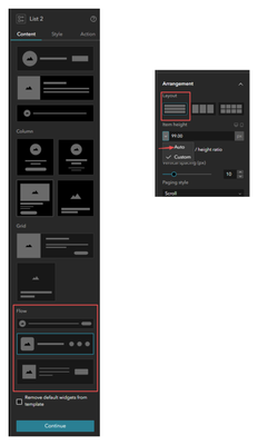

Wei_Wang
Hi, @Teresa_Blader thanks for your response.
1.In the June 2026 update, we added support for Auto item height in the List widget under the Flow template. Item height can now adjust automatically based on the tallest text or image widget inside the item.
This dropdown appears only when the template is Flow and the layout is Row. Auto item height is not supported for ROW or Column templates.
2.Based on your screenshot, it looks like you are using the Row template. In that case, the item height dropdown for Auto should not appear.
Does the original issue still happen when you use the Row template?
3. When switching between different sizes, List widget settings should stay the same in Auto layout mode. If you click the Custom button next to page layout and then switch back to Auto, the item height is currently expected to change. We will follow up on this issue.
Teresa_Blader
Oh - you are right. I didn't really notice the differences between those templates types. But I see that now.
I did go to Flow later, and then saw the auto drop down button in the List widget for height. For my purposes, that behavior with Flow and the auto button is exactly what I was looking for. So for this app, just changing the list template to Flow is perfect.

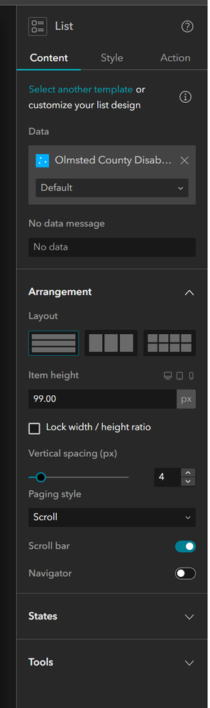

When I started - it was a Row template. This was where I was keeping all three screen layouts as "Auto" vs "Custom" but found that "Auto" was still retaining the "Custom" list heights even after setting it back to "Auto". And I didn't even set the heights to 4 or 9 pixels so it just decided to do that too by default.
What I could do is turn on "Custom" for the screen layouts, change the heights in List for each screen layout, then turn back on Auto - to at least get it to stop being like 5 pixels tall. But it just retained the new custom height settings regardless of changing to "Auto". When I investigated my other Lists in other Apps further - they all had Row templates, but custom was turned on for the screen layouts - so those won't good comparisons after all.

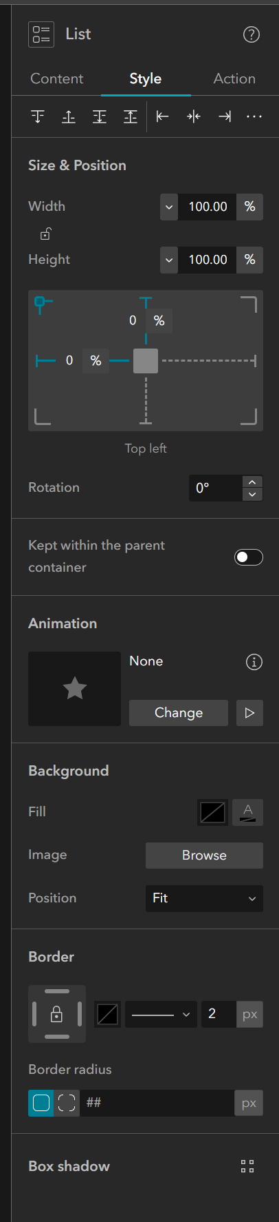

JeffreyThompson2
MVP Frequent Contributor
The Style Tab can be different for different screen sizes. Check to see if they are all set to same values.

Teresa_Blader
Yep... all identical.
