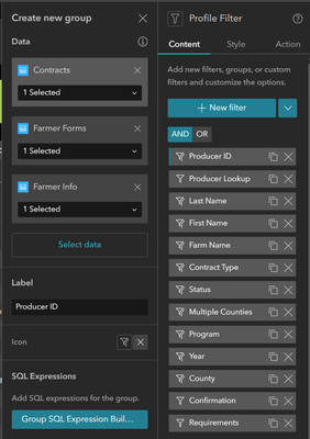

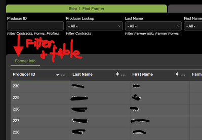

Group filter with small integer field isn't working with unique selectors. It worked just fine for the past few months and then today isn't working. I cannot scroll through. I hit search, start to type, and then it just can't do the search. It just spins and spins. This worked until today I was alerted about it. No changes to the ExB were made in the meantime. This happens with both the drop down and expanded. I can use 'User Input' and it works fine to filter.
My other group filters with drop downs don't seem to have this issue, but they are string.
The field is identical between all three layers in the group filter, has the same range of values even.
I tried clearing browse cache, removing the filter, re adding it. I'm stumped. I don't see any corrupt values in the search. There are no null records or anything.

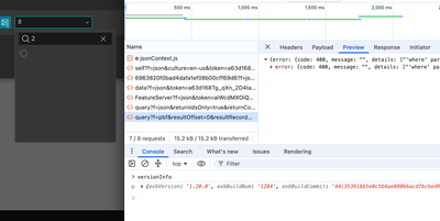

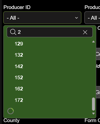

There is a range of values between 1 and 230... so when I type 2, I should get all of the ones that start with 2. But it like crashes after digit 1. It will briefly show one match and then the suggestion disappears right away.

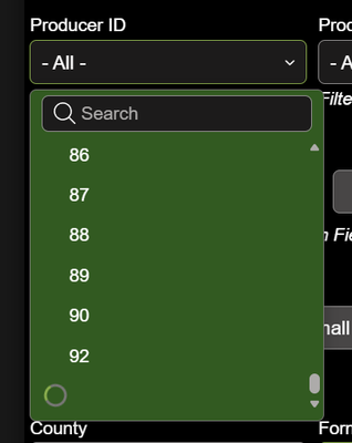

 No search: seems this it works... but...
Scroll down, can't return all the records.

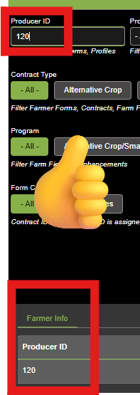

User input works fine:

@Teresa_Blader We gave it a test and found out that it is not a new issue; it occurs on the last version as well. Do you have a sample app with the data to share with us? Thanks

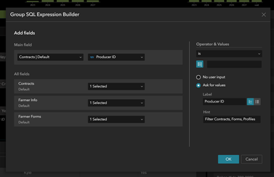

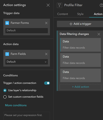

This quite a complex project actually so I don't have a sample app and I also can't just share the data. I can however share a blank dataset that i created for my other esri support ticket related to survey123 reports. However I'm fairly certain you will probably look at it and not understand the data structure... or maybe you will. The group filter is attempting to filter the producer ID field in the tables Farmer Info, Farmer Forms, and Contracts. In my data there are 230 producers in the Farmer Info table with unqiue producer IDs. This filter then also has actions to impact all three tables.
actions to trigger the filtering better:
