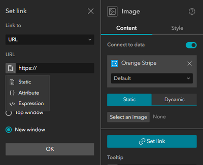

In your Online/Enterprise environment, build a hosted feature table that contains all the data needed to generate one of your index cards, including a field that will be used to name the pages. Use this table to connect to a List Widget. Set a link in your List Widget using the expression option. It will look something like, https://mywebsite.com/{nameField}.
Any data changes in the table should be reflected in your website. Adding a new entry to your table should automatically generate a new card and link, but you will still need to build the actual page contents.
