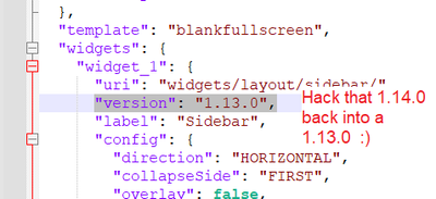

1. Backup your config.json in your C:\ArcGISExperienceBuilder\server\public\apps\0\
2. Edit the config.json in your C:\ArcGISExperienceBuilder\server\public\apps\0\
look for any referenced widgets that have a version higher than your ExB Dev Edition (I am guessing you run V1.13 as of March 2024) .
Do this for any new version of ArGIS OOTB ExB widget
Save the config.json
Also overwrite the -other- config.json that is located here C:\ArcGISExperienceBuilder\server\public\apps\0\resources\config
re-run ArcGIS ExB Dev Edition and try loading your project (pray the good lord)
**This is a hack**.  Revert back to original files if it doesn't work.

8. look into that config.json and try to identify any widget that has a higher version that your ExB Dev Edition
(example : you might see 1.15 or 1.14,  whereas your ExB is only V1.13 -- that's what is causing your yellow warning )
some widgets simply do not exist yet in ExB Dev Edition, such as the brand-new advanced Select  Widget https://doc.arcgis.com/en/experience-builder/latest/configure-widgets/select-widget.htm   - so that will never work until a new ExB dev edition gets released and (hopefully) includes it too.
Summary : the above tricks are hacks .  The easiest is to wait for the new ExB dev edtion to be released
