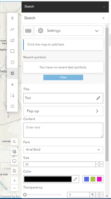

You just want the map title? You may be able to hack this by adding a Sketch layer to your webmaps and adding your map titles as text.

Thanks for this, but I wonder whether this workaround would work independent of the zoom/zoom out functions, or if the map is swiped to a different area - ie the text isn't fixed to any location?
