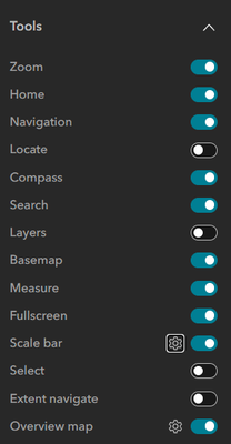

I'm experimenting with the map widget in Experience Builder and I was wondering if it's possible to edit the amount of base maps the end user has when the base map option is turned on?
I'm not entirely sure if this would directly be possible through Experience Builder or the Web Map which the Experience Builder is pulling from.
Basically, I only want the end user to be able to select from four different ESRI base maps instead of the whole range that is offered. Would it be possible editing the JSON?
Any help would be greatly appreciated. Thank you!

Julia_vanRavenswaaij
Unfortunately the Basemap Widget and the Basemap toggle under map tools do not seem to correspond. You can edit the basemps with the widget, but not the basemaps used in the gallery that you turn on with the toggle. There should be a settings option there as well.
