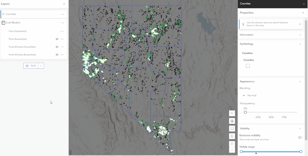

Hi ,
I am trying to create an Experience Builder map with 4 layers inside a group, but I want the user to only select one out of the 4 with some sort of radio-button.
I looked in the web map itself on ArcGIS Online and also looks for options within Experience Builder 1.7 itself (Map Widget's Layerlist customization?), to no avail.
Is there some "exclusive"  setting for a layer group?  So that only one layer within that group can be selected.
Thank you
lzk222
You will need to create a group and place your layers in the group. Then in the group Properties, under Visibility, toggle on Exclusive visibility (aka radio buttons).
