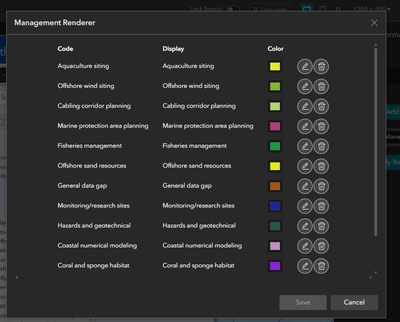

I use a modal window in my widget and it is scrollable. The window uses a component from a third-party library to build this editable table and uses a CSS file to provide its styling.
This is the code in the tsx file
  return (
    <Modal
      isOpen={modalVisible}
      //className="bg-default w-75 d-flex justify-content-between"
      className="bg-default w-100 d-flex "
      <ModalHeader closeIcon={<CloseOutlined />} toggle={toggleModal}>
        {title}
      </ModalHeader>
      <ModalBody className="w-100">
        <article className="table-container">
          <table>
            <thead>
// etc...
and this is the css file with the overflow property
.table-container {
  display: flex;
  justify-content: center;
  height: 500px;
  overflow: scroll;
 resulting in this table with the scrollable content
