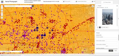

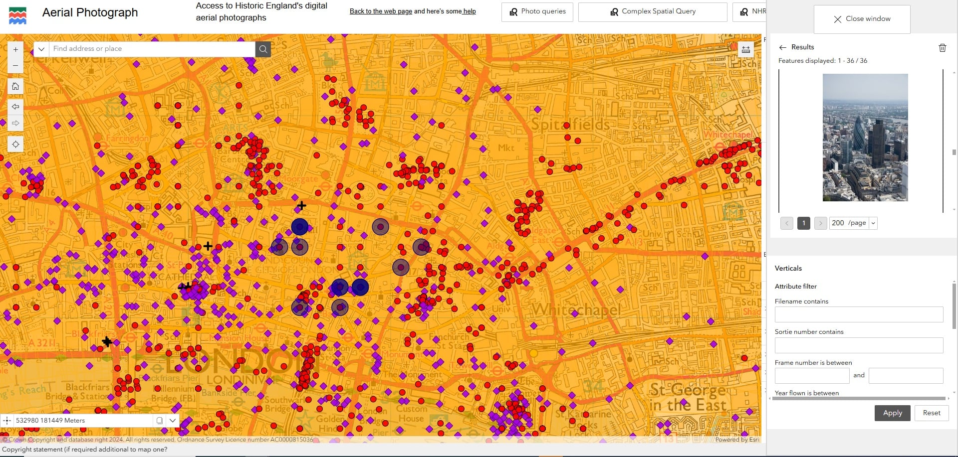

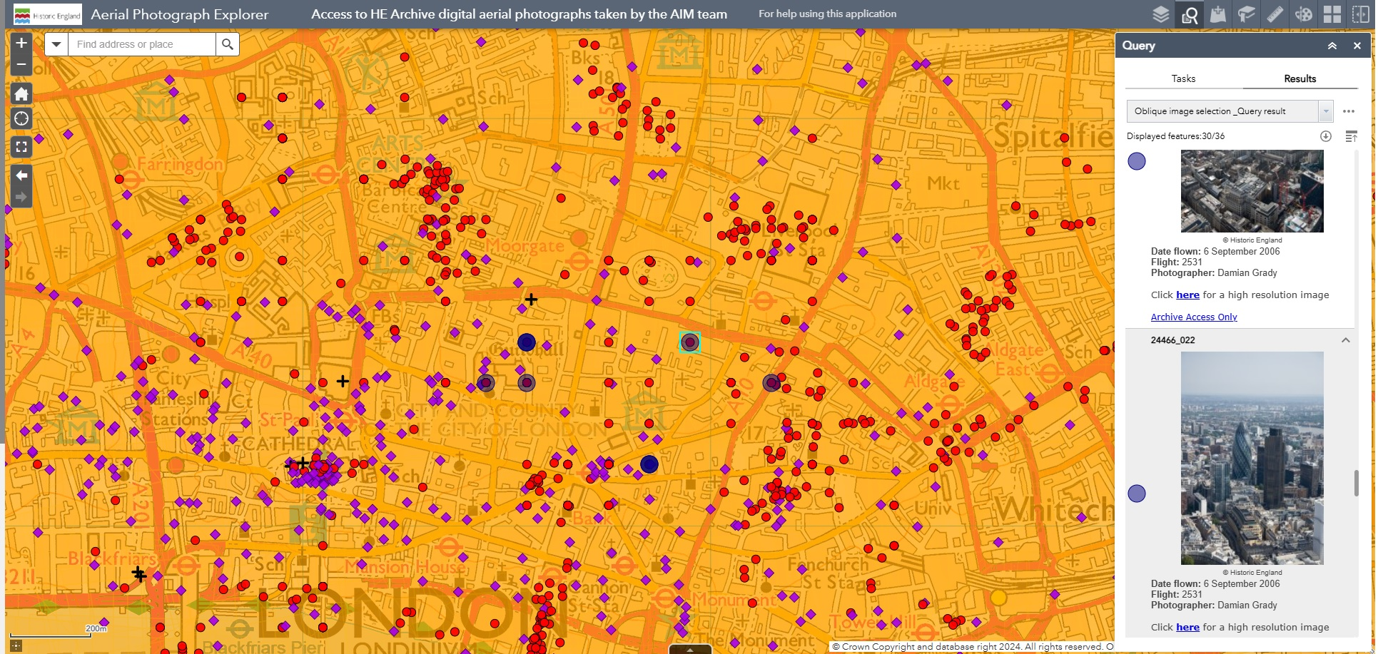

When you run a query it is possible to set the results to appear on the map and zoom to them. However, you may have run a query that pulls back tens or even hundreds of records and zooms to the full extent. If you zoom to a single one, by clicking somewhere in the resultant box, the map centres on the feature, but there is no differentiation of the feature. In WAB a highlight box used to appear around the selected feature so you could see it.
There doesn't seem to be any obvious way to do this in EB, unless I'm missing an advanced feature somewhere.

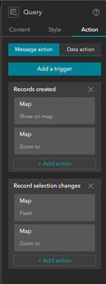

Go to the Action Tab and set up a Record Selection Changes Action. Any of these should highlight your feature on the map. If you just want a highlight, Map > Flash is your best option. You might also want the Map > Zoom To or Pan To or the Framework > Select Data Records options.

Hi Jeffrey, I've already done this with 'Show on map' and 'Zoom to' for 'Records created' and 'Zoom to' and 'Flash' for 'Record Selection changes'. Unfortunately, as far as I can tell this produces the effects in the query and highlights all the results, not the induvial feature.

Sorry Jeffrey, but it's still not working for me and changing the feature selection colour in map seems to have made no difference. It was the default cyan, but didn't show before. I've now changed it to red, but it's still not showing. I've tried various triggers within the map, but they don't seem to make any difference. I'm clearly not understanding something.

I'm not sure why this isn't working either. Here is the order of the Actions I set up.

My 'Flash' and 'Zoom' were originally in the opposite order, but even though I've changed them still no joy.
