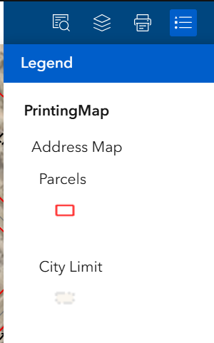

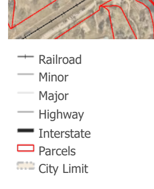

Is there a way to remove layers from a legend within the print widget result in experience builder? I have a use case for making a static map online using the print widget. In Web App Builder the print widget honored layer visibility set in the legend widget. Now layer visibility for the legend is set in the map viewer but it is not honored in the print result legend.
Screenshot of legend widget
And here is a screenshot of the legend in the print result
I'd like to be able to remove the railroad and centerline layers from the print result legend just like in the legend widget.

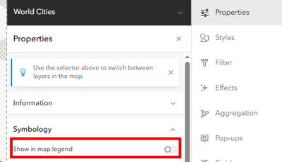

This is how I set it in the Map Viewer:

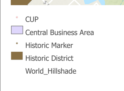

We are on Enterprise 11.3. I did some testing in ArcGIS Online and was able to recreate the error. The error occurs when I use a map service with multiple layers instead of just bringing in an individual layer from the map service.
Legend widget in experience builder:
Legend in the print result:
