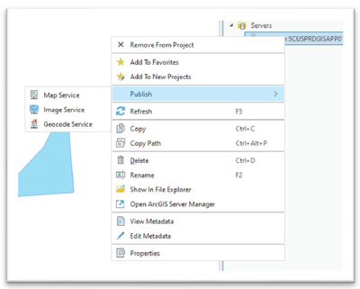

Have you tried publishing as a map and checking this?
Otherwise it will change your symbols to match the newer updates - for things like EXB, new map viewer, dashboard and instant apps. I have published groups of layers, symbolized, and all worked well in EXB.

Hi Laura, thanks for your reply.
My company has a Standard Operation Procedure, and they require me to publish as a map service, that's why that checkbox doesn't appear, I believe.
