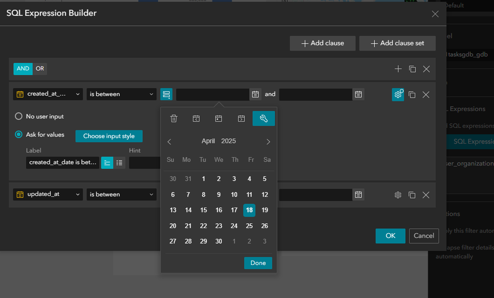

RupjyotiChangmai
How to Activate Calendar Filter in Experience Builder – Hidden but Powerful
After some R&D and hands-on exploration, I discovered how the calendar filter works in ArcGIS Experience Builder — and it’s a bit hidden, which explains why there’s limited documentation or discussion around it.
Here’s what I found:
Experience Builder handles date filtering similarly to a calendar filter — but it becomes available only after adding specific conditions.
Steps to Activate the Calendar Filter:
  1. Add a Filter widget or configure a filter in your data widget.
  2. Ensure your dataset includes at least one date field (for example, I used Created Date and Updated Date).
  3. In your filter settings, choose the condition: "is between".
  4. Enable "User input" for that condition.
  5. You will now see five options appear:
    Empty, Yesterday, Today, Tomorrow, and Custom.
  6. Select Custom, and the calendar picker becomes available for dynamic filtering.
From what I understand, this feature was likely already part of the builder but not clearly documented — as many users, like me, have been actively searching for it.
Hope this helps others uncover this powerful filtering feature.1060_639_1.png
