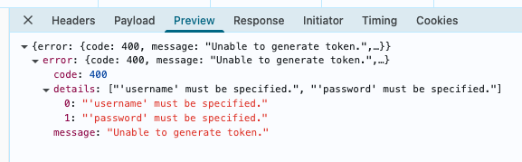

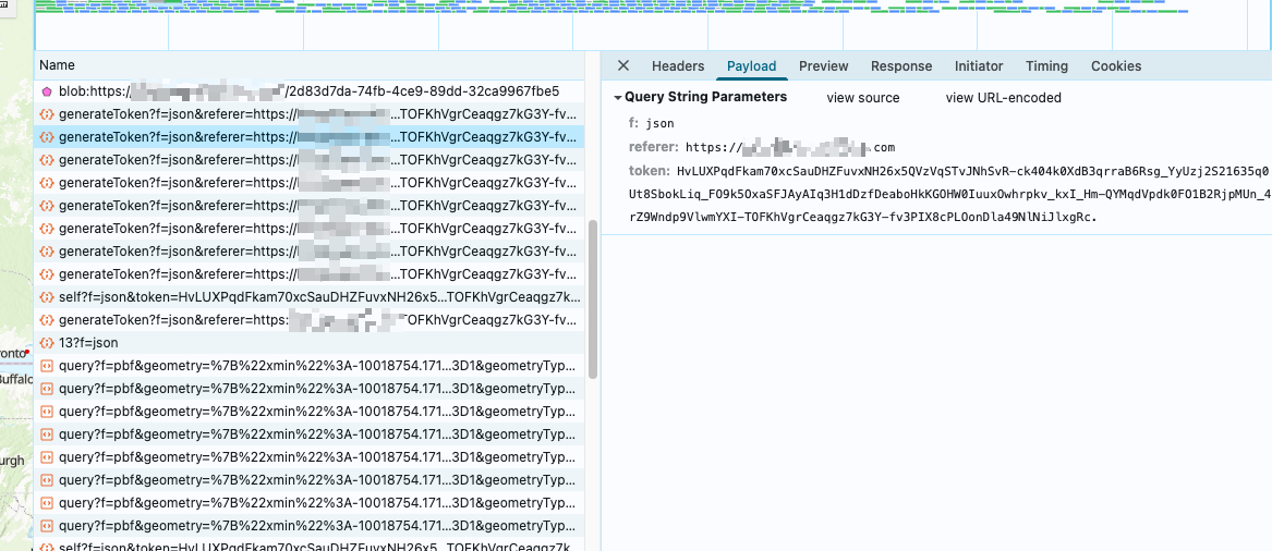

The search & query widgets for experience builder stopped working correctly and I noticed its trying to generate a token based on a token. This creates a 400 error.
Sometimes I'll see a result after a while but mostly it just sits there spinning.

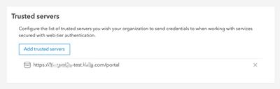

We eventually figured this out ourselves. The problem was that the portal URL had been added to the Trusted Server setting in Portal for some reason (ie it referenced itself).
This had been done in our dev and test environments. Once we removed this, the issue/error went away.

I'm seeing hundreds/thousands of generateToken messages with the same response shared by the OP.
