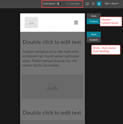

Hi @CP_Leipzig ,
If you disable live view and lock layout, you can enable a Custom layout for header at different screen sizes.

ShengdiZhang
If you only see one Auto/Custom, it is because you don't have the Header enabled.
So, enabling custom means having a custom layout for body, but the result will be the same.
