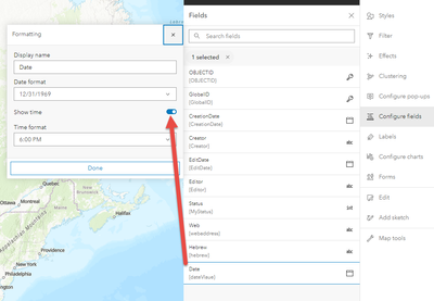

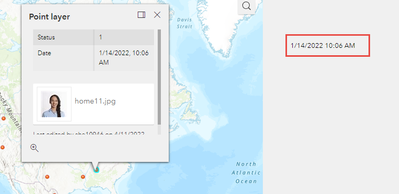

I cannot reproduce your issue, the date format in my text widget is the same as the format of the map popup:
Can you check if the time is also not displayed in the map popup window? And do you have the "Show time" option enabled in the map viewer?
