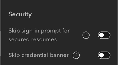

Wei_Ying
The two options are available in Enterprise 12.0 and Developer edition 1.18 or later.
You can use the new Security settings to turn off sign-in prompts. Specific parts of an Experience Builder app may prompt users to sign in with an ArcGIS account. You can turn off prompts that ask users to sign in the view unshared resources. If you do, the app only loads content that is accessible to the current user. You can also turn off the credential banner, which is the banner that appears if an includes widgets, data, utility services, or other components that require an account with certain privileges.
