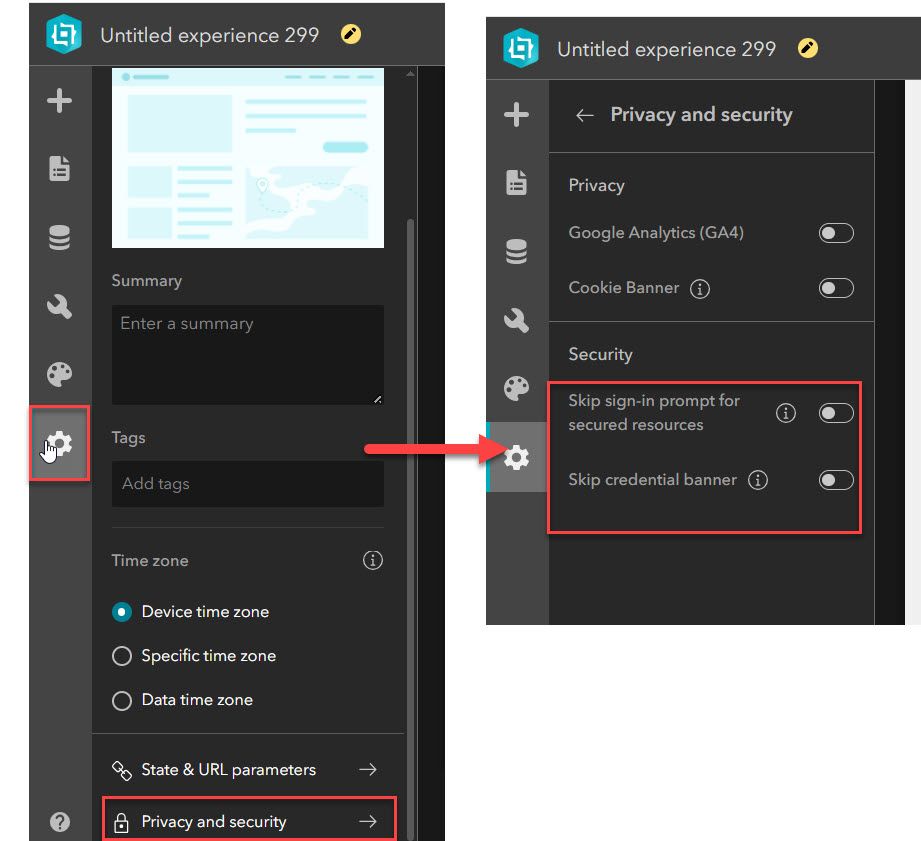

Can you help me figure out how to configure the app so the warning doesnt show?
Wei_Ying
In Experience Builder of AGOL, please go to General setting of experience, and then click "privacy & security".
Under the security section, use the two new options "Skip sign-in prompt for secured resources" and "Skip credential banner". 2025-07-12_13-43-30.jpg
