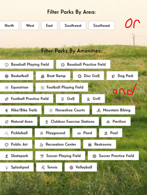

It is possible to use a large number of filters on a single data source. Here is an example that allows the user to select from up to 35 filter options.
There are two Filter widgets on this page. The area filters are connected by OR logic and the amenities filters are connected by AND logic.
