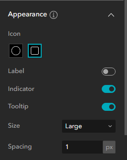

I am unable to increase the size of the widget icons on the widget controller. When I open the settings and change the size under appearance, it only increases the spacing between the widgets, not the size of the icons. I am currently using Developer Edition 1.15.

Set to small:
Set to large:

Hope this is related to what everyone needs help with:
To resize a widget in a widget controller:
1.) Click the Widget Controller
2.) Under the "Appearance" section of the Content tab of the Widget Controller settings, change the Size to "Custom".
3.) Increase/Decrease the Icon Size as desired. Button Size/Spacing seem to be very similar to each other and can be modified after you set the right size of your icons (be sure to modify the Widget Controller size in your page to give your self the room to play with the sizes.

It looks like your widget controller is placed in a container that has the same background colour as your controller icon's background colour. Try using a different icon background colour in the Advanced settings of the widget controller settings panel.
Changing the size of the widget controller will modify the padding of widget icons, but the icon size will always stay the same. ExB doesn't support changing icon size at the moment.

Thank you , it looks like this was introduced in the October '25 AGOL update / 1.19 DE update and I was able to implement it a few months back. I was able to get my widgets to match more closely to my header size.
