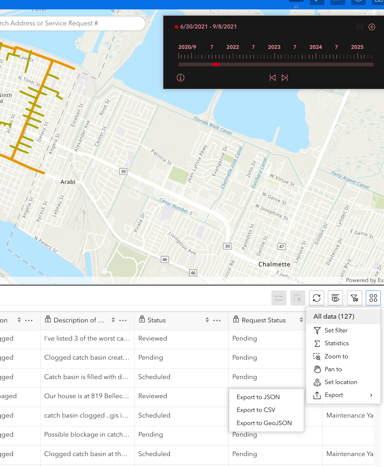

I've setup a timeslider widget for drainage service requests. The timeslider works perfectly and filters the requests to a range of two dates. The filtered requests show in the table, however, any attempt to export this filtered set to csv results in the entire data set being exported.
The example below shows a small date range which filters the service requests to just 127 records. This shows in the table below. However, using the export to csv will export the entire 5000+ records.
Anyone have any ideas?
Thanks!

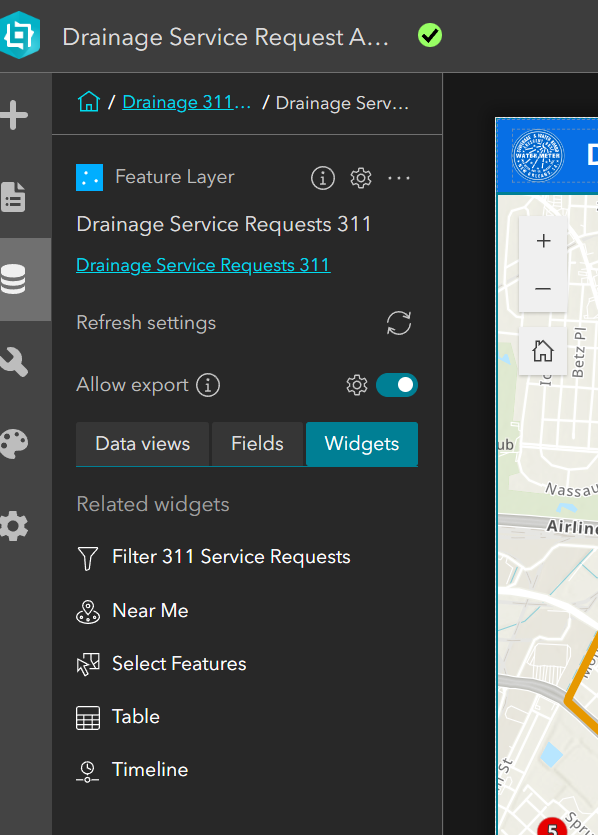

In addition, I have also checked the Data tab which governs the exports, it clearly has the timeline widget listed as a related widget to the layer.

Hi @JeffreyROLAND ,
Currently, we only support printing the correct data when the timeline widget is connected to a web map. For more details, please visit the following link: https://community.esri.com/t5/arcgis-experience-builder-questions/print-widget-with-timeline-issue/m...
If you connect the timeline to the web map and are still able to reproduce this bug, could you send me a sample app?
