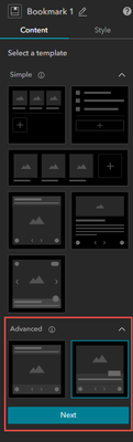

You can try the advanced bookmark template, with which you can add widgets and create a unique design.
Refer to https://doc.arcgis.com/en/experience-builder/configure-widgets/bookmark-widget.htm#GUID-403E0197-F3F...
Hope it helps,
