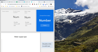

I have tried that, here's a better example of what I mean. I am working with users who sometimes only have their laptop (so don't have two screens) and they need to be able to see two windows at once. Experience Builder moves the objects on the page around to make it fit in all one view, but the user would prefer to scroll rather than having the objects readjust. More importantly when I make the window smaller, all the widgets revert back to templates, not what I've published.

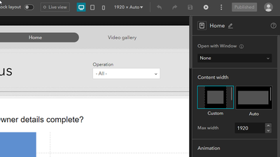

The screen size is 1920x1080. I have also changed Content width to custom- 1920 max.
Screenshots of published item, but only using have the screen.

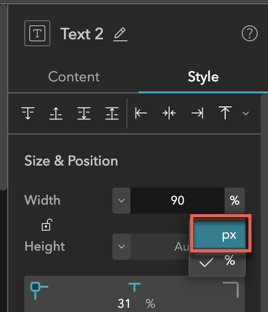

There are two types of Unit that control the layout - pixel and percentage. Usually we use the pixel for the full screen and percentage for the scrolling page. In your case, the widgets on the scrolling page by default are in the percentage therefore their positions change based on the width and height of the browser. You may change the unit to px as shown below for the fixed width and height.

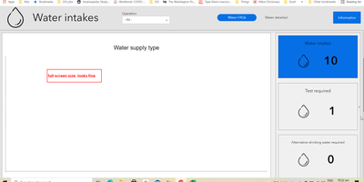

Thanks for your reply. I have changed all the blocks to 1920 px width. It looks promising, but there are still some issues.

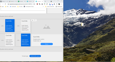

When I use the ExB in a smaller screen, the wider parts are cut off or the background colour doesn't show properly. I took a video showing the issue.
This video shows how it works in a 1920 screen, but when I make the screen size smaller, the widgets do not refresh.
