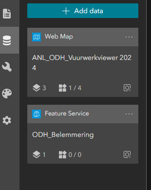

in the left choose data and you will see what is connected to the ExB. click the ... and choose remove.

thanks! I don't find that particularly intuitive, but I see it now.
