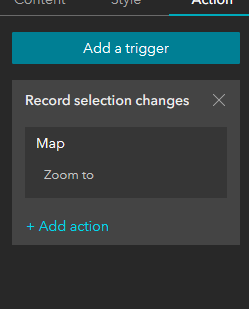

RyanSmithTONH
I am using the "Record Selection changes" action on the search widget, with map as the selected widget and zoom to as the action (I have tried this with the same bad results using the Pan to as well).
lleveto_CCPC
Well then this may or may not be helpful. We were experiencing a very similar behavior with our search widget, which was tied to "local" layer sources. Originally, our configuration for the zoom/pan actions relied on the data filtering trigger working with the framework data, which was my first thought with your problem. The fix provided by ESRI was to switch the zoom/pan actions as a record selection action and tie it directly to the map widget itself and not the framework data. That seemed to solve our issue, not sure if that can be applied to your situation, but it might be worth a shot.
