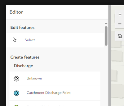

I was wondering how I could remove the "Filter types" in the Edit Widget. See below:
I'm working off an Experience Builder template.

I have the same issue. I only have three different classes so I don't need the 'Filter types' box. The box actually makes things confusing for my users. It would be good if Esri would provide an option to hide/remove this box in the Edit widget in Experience Builder.

You'll be able to hide the Settings dropdown and the Filter types search box with the upcoming June update of Experience Builder:
