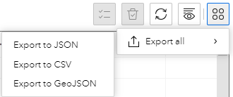

I've created a simple ExB: it has a table widget and a couple of filter widgets. The purpose of the ExB app is to allow users to filter the data in the table and download it onto their device. All the settings - the hosted feature layer that is connected to the table and the setting inside the ExB app itself - are set up to allow data export. And it does. But...
When I use the 'Export to CSV' option, the browser's pop-up blocker is engaged and blocks the file from being downloaded. I need to go into the pop-up blocker window to "release" the file and let it download. manually.

You are correct. After contacting my IT department, they added the needed URL to my Chrome's pop-up list. And that solved the issue.

I was tearing my hair out trying to help a coworker with this! When I an export finishes downloading, it opens another tab for a split-second before the download actually appears in the Downloads folder. With browser pop-ups turned off, that tab can never appear. Why is that a required function for the export to work?? I don't know anyone who willingly enables browser pop-ups.
doronwen
You can still have your browser set up to block all pop-ups, but you can allow some app to send you pop-ups using a URL.
My Chrome pop-up is set to "Don't allow sites to send pop-ups or use redirects", but under "Allowed to send pop-ups and use redirects" I have my organization's Portal URL.
