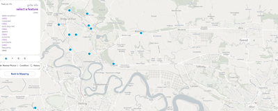

I am trying to pre-select data for an ArcGIS Experience Builder Web App that I'm making. I want to do this so as to not have a blank area when the user opens the web app. I have attached what currently is the default view as well as what the selected view looks like.

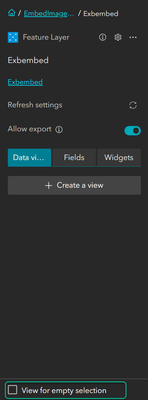

Hi @Anonymous User
I believe your requirement can be achieved by using the View for empty selection feature inside the data source settings (instead of widget setting, since this applies to all places using this data source):
After checking this, the default value to display is the first record. If you want to customize it, go into its setting and use sort or filter to choose the one you want.
See the Select data doc for more details. Hope it helps.

So, the user interaction is to select an item on the map within your app and see the selected info?
If so, then all you have to do is ensure, within the card you've created, you don't use "Selected Features" but "Default" within the dynamic fields, but you do make sure the data action from the map is to "on select change framework"
I've thrown a field into this screenshot for an example.
Card on the left has fields set to "Selected", the little box on the right is set to "Default" for dynamic fields - Default just brings through a first record, regardless of any selection.
if I make a selection then you'll see both details change accordingly.
This means, as long as the user knows to select data and  isn't put off by always getting a record given to them on open, then all is good.
Me, you'll see on the first grab, I've got the dynamic field asking the user to "Select a Feature". You could think about the way that first experience is shown, and change the wording of the dynamic field. (hope this makes sense?)

Thank you, Tonghui! This worked perfectly.
