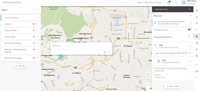

I use this map to test and see it does not display content in FeatureInfo. However as investigated, from map viewer the popup of the layer "Joint use park" is empty as well, so it is expected that FeatureInfo displays nothing. I think it is a bug for JS API.

Hi @BriannaTatum  the problem should be fixed in online patch. Please try again.
