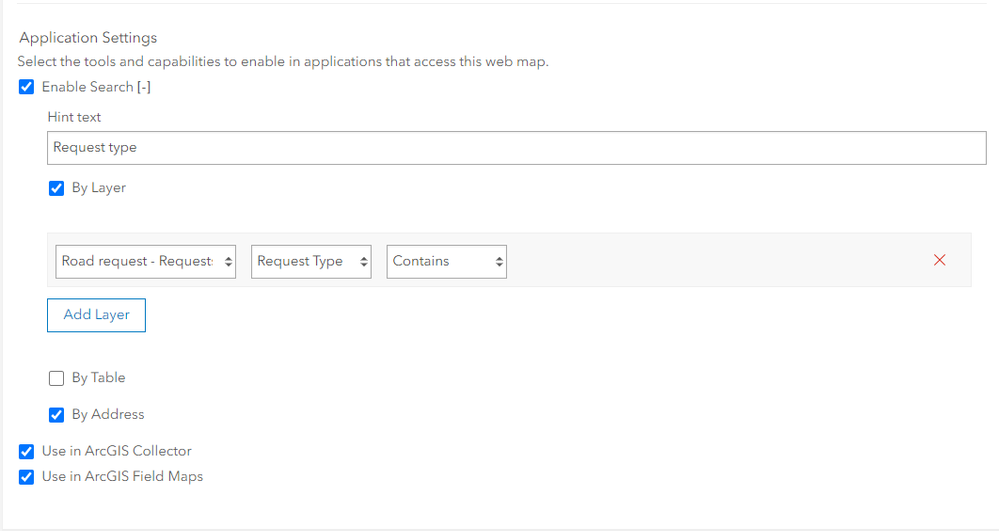

AzizaParveen1
Hi @AngelaEngland1 ,
You can configure the map to layer attributes in the web map detail page, open your map in ArcGIS online and then click Settings -> Web Map, then browse to Application Settings. If you configure your map to search your layer, you will be able to search by your layer attributes in Manager Instant app. Only thing is you won't be able to edit geometry in Manager at this moment but it is in our road map
