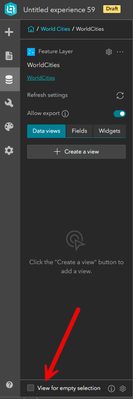

Hi @DfIRivers ,
You can check the "View for empty selection" option to avoid displaying field names when there are no selections.

Hi @ShengdiZhang , I've had a look at this option, and whilst it allows data to be displayed on my 'Inspections' page instead of field names.. the data that's displayed doesn't correspond with the particular asset chosen (on my 'Overview' page), or the list of inspections on my 'Inspections' page.

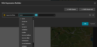

You can set more conditions here:
How to select the first record depends on your data structure, given the sorting in the list widget I would suggest using the Date field.
DfIRivers
Hi @ShengdiZhang , I can see the option to set a clause, but can't figure out a way to use it to select the lastest 'inspectionDate'.
ShengdiZhang
Hi, as I said, it depends on your data structure.
If you can't use an existing field to formulate the proper condition, you can add a new field, name it select_id for example, set the select_id to group by asset and sort by Date, and then add the condition of select_id=1 for your case.
