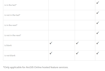

The four date-related operators are only applicable for AGO-hosted feature services. Check the documentation here:
https://doc.arcgis.com/en/experience-builder/latest/configure-widgets/filter-widget.htm#ESRI_SECTION...
The reason, FYI, is that other data sources may not honor the timestamp so that's why there is a limit.

TonghuiMing
To be more specific, it is because, for AGOL-hosted databases, it is certain that CURRENT_TIMESTAMP is UTC. However, it is not certain that this is the case for other databases. It is not a limit from Experience Builder, it is a limit from the service side.
