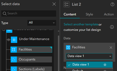

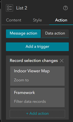

ToddW_stl

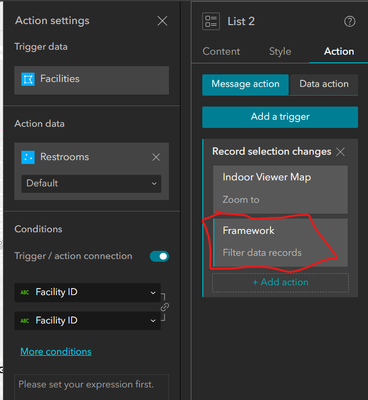

if your trigger is "Record selection changes", do you have a Framework action to "Filter data records"?
I have 2 lists in my app - the first list (could be a list of unique "Tree types" for you) filters down my map and a second list (could be a list of parks that have that tree type).
  • 1st list:
    • Action tab > Message action > Record selection changes trigger > actions: Zoom to (on the map) and Filter data records (on the Framework)
    • when i click a row in the first list, the 2nd list filters and the map zooms to the building
  • 2nd list:
    • Action tab > Message action > Record selection changes trigger > actions: Zoom to (on the map) and Filter (on the map)
    • when i click one of the filtered results in the second list, the map zooms and filters to that specific point
I can't show the map data, but attached a gif of the list behavior below.

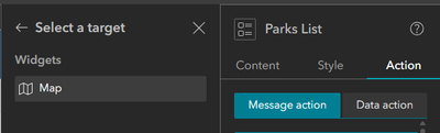

cjms

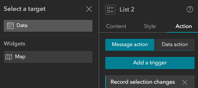

Thanks for response and GIF. A couple of follow-up questions:
  1. How would I get a unique list of types? Do I need a third layer that is just a table of tree types?
  2. How do you set the actions of one list to interact with the other? My list only shows the Map widget as a selectable target

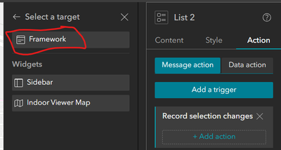

ToddW_stl
if it matters - I'm using the version of ExperienceBuilder that comes with ArcGIS Enterprise 11.5 - please let me know what tech/version you're on!
I'm not sure why you're only seeing Map...  what do you see when you click List > Action tab > Message Action sub-tab > Add a trigger button > Record selection changes button?  This is where I see "Framework".  Essentially (as I understand it at least), when I select a record in the list (trigger - record selection changes), I want to apply an action that affects the entire app or any/all data used everywhere in the app (framework), and I want to Filter (action) that data by the configured field and attribute that I'm displaying in my first list.
In my case, not every building in my data has the a feature of interest, so I had to create a data expression and manually select the buildings I wanted to show in the first list.

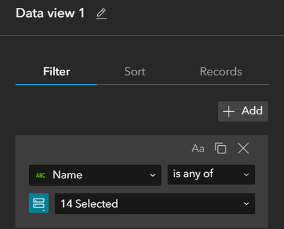

ToddW_stl_0-1769950273208.pngToddW_stl_0-1769950273208.pngToddW_stl_1-1769950298736.pngToddW_stl_1-1769950298736.png
cjms
I'm using ArcGIS Online, so whatever version that one is at.
Ah, I see if I use the Record Selection Changes, I have a data option. I was using the using the trigger Data Filtering Changes. I'm guessing the difference in AGOL and Enterprise is why this says Data instead of Framework.

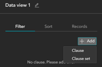

I guess now the problem is that when link my List 2 to Trees, it gives a row for every tree, whereas I want a distinct list of Tree types from my tree layer. You mentioned data view, but my only options are filtering and sorting; I don't see any way to do a SELECT DISTINCT tree_type.

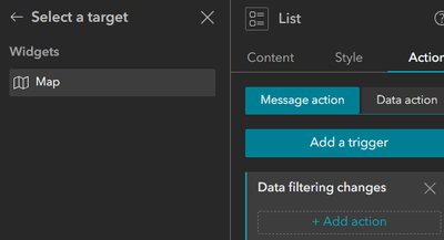

Thanks for the link! The Unique in SQL works great to get a distinct list; however I'm still left with the problem of having the filter cascade from one list to another since the only available target for Data Filter Change is the map (pan, zoom, flash).
Using Record Selection Change DOES work to filter the list, so I guess that is kind of what I want? That's a bit inconvenient though that I would need to use the Filter first, then select an item from the first list to filter the second list. Hope that makes sense.
Seems like if the Data Filter Changes trigger could target something more than just the map, that would solve my problem.

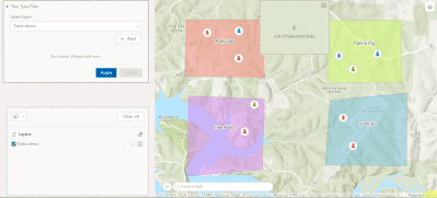

I think I figured out a pretty good solution in ArcGIS Online with the following assumptions after re-reading some of this thread more slowly:
  • you have a point layer of Trees with attributes that represent "tree name", "tree type/species", and "park where the tree lives"
  • you have a polygon layer of Parks where the only important info is the polygon geometry (park location) and an attribute like "park name"
  • the Trees layer "park where the tree lives" attribute strings exactly match a Park layer polygon with "park name" attribute
  • Desired workflow:
    • filter Trees by tree type/species
    • use filter above to filter Parks to only parks that contain that tree type
    • see a list of the filtered Parks
    • optionally pan/zoom to a specific resulting park location on the map
I achieved this in ExperienceBuilder (see demo gif) by:
  • add a web map which contained my hosted tree points and park polygons layers
  • add a Filter widget for tree type
    • set to use custom filter on tree layer (default)
  • add a Select widget for spatial filtering
    • spatial selection - select by tree layer (default)
    • action
      • trigger: record selection changes
      • action: filter data records
        • trigger data: trees
        • action data: parks (default)
        • conditions: park name/park name
  • add a List widget to show resulting parks
    • set to use parks data (selected features)
    • no data message: "List of Selected Parks"
  • add a Search widget to search/find/pan/zoom to a specific park
    • interact with map
    • add parks as search source
      • search options: park name field
      • hint: Find a park
I hope I didn't miss anything, but let me know if you have any issues/questions!
Happy mapping and apping!

You can trigger List widget filtering by configuring the Action settings within the Filter widget. Here are the steps:
  1. Go to the Action tab and select: Add a Trigger->Data filtering changes-> Filter data records.
  2. Set Trigger data to Layer 1 (Filter widget) and Action data to Layer 2 (List widget).
  3. Set Trigger / action connection: Match the identical fields from both layers (e.g., the "park" field) as the Trigger field and Action field.

I’m experiencing the same issue. I’m using ArcGIS Experience Builder 11.5 (Enterprise), and unfortunately I cannot find the settings you described.
You wrote:
“Go to the Action tab and select: Add a Trigger → Data filtering changes → Filter data records.”
→ However, I don’t have the option “Filter data records”.
The only options available for me are the Map Widgets, where I can trigger pan or zoom actions.
