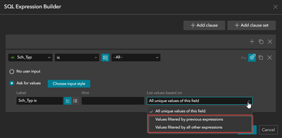

DanCopKac
anywhere you have a widget with 'SQL Expression Builder' you can make a query that shows filtered lists:
MohaRIZKI
Yes, that possibility exists, but the dropdown only filters based on the attributes of the layer. What I'm looking for is a way to have a list of layers where, when a user selects a layer, it appears on the map. Do you know if that's possible?
