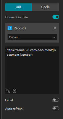

jcarlson
MVP Alum
  1. Make sure the widget is connected to the data.
  2. Start typing your URL
  3. Click the database icon and select the attribute you want to pipe in.
That should be all you need. If this doesn't work, please post back what you're seeing, and hopefully we can get to the bottom of it.
- Josh Carlson

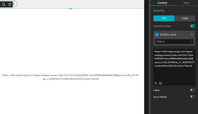

LaraJuliussonUSFS
@jcarlson - Hi Josh, I found this post and I am having the same issue as Keith was. I am using Experience Builder on AGOL. I am trying to embed a Web Map app. I went into the web app and added the Share widget to find out the structure of the query that I need to show the web app the way I want. It is this:
https://MyWebAppURL&query=USA_Wildfires_v1_8284%2CIncidentName%2CBOLT%20CREEK Note that if I enter this full url (with the correct url for my app) the web map app comes up in the embed widget as I want.
I then type into the embed widget Embed by URL box the url without the query value:
then I go to the data insert button below the URL text box and select data from the result of a query, which I know is returning "Bolt Creek" (I've confirmed this by showing it in a text widget). The URL after I've done this looks like:
https://MyWebAppURL&query=USA_Wildfires_v1_8284%2CIncidentName%2C{Incident Name}. When I enter, all I get in the embedded widget area is the URL itself.
Any ideas? I'd be extremely appreciative if you could help me!
