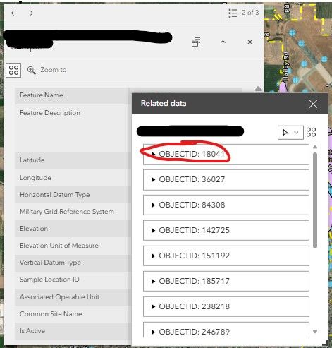

I am trying to configure the pop-up for my related data in Experience Builder to display custom fields vs defaulting to Object ID. We were previously using Web Applications and were able to get the related data pop-up to display how we wanted by configuring the pop-up in the web map. It doesn't seem to be working the same way in Experience builder. Below I've included a pic of what the pop-up looks like in the Web App vs Experience builder. We'd like to get the Experience Builder Pop-up to look like the Web App. Is there a different area to configure this information for Experience Builder beside the pop-up configuration in the web map? Any guidance is appreciated!

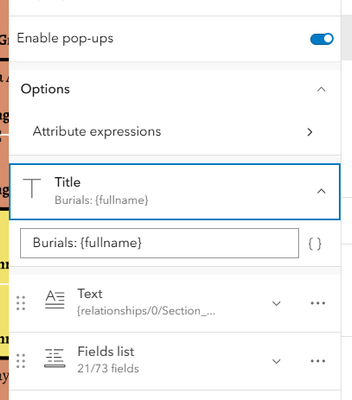

I've tried that and it's not working. My configuration in the Web Map vs what is showing on my app is below. Again...it shows up correctly in the old web mapping application, so not sure what the disconnect is with EB. I can't find where it's getting these titles from.

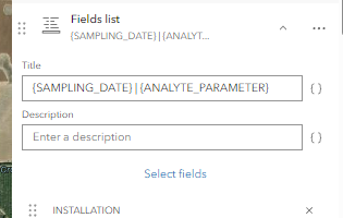

It looks like you are adding a title under the fields list popup section rather than a title to the whole thing.
Not sure if this will fix or not but give it a try

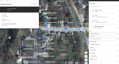

Another map I checked with (this one Enterprise):

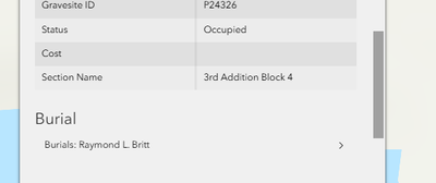

When I go into the layer and click related records. I can sort by and chose date and you can see here they are sorted by date.
Going to the related table popup you an see how I set the overall title. So in the popup it displays both the title and the date as expected above.
Make sure you add the related popup to the OG layer and configure popups on the table. Within EXB I then set it to automatically expand the result of a query to see the popup.

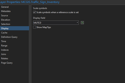

Can you check the display name of the layer and if one was configured? Usually this is set in Pro prior to publishing the layer. It could be displaying based off of that.
https://support.esri.com/en-us/knowledge-base/how-to-change-display-field-using-arcgis-server-servic...
Maybe you can overwrite the layer with the correct display name?

I had high hopes for that last solution of overwriting the display name, but that didn't work either. It's so weird. It shows up fine in the old web mapping application when I configure the pop-up for the related data table, but not in Experience Builder.

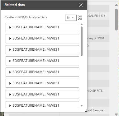

I have the same issue, a related table in the portal instance is not respecting the title configuration and just defaults to ObjectID. in the old WAB i was able to configure hyperlinks at the title level too, but not the case here either.

Has anybody found a solution for this or gotten any reply from ESRI? I am having the same issue. Can't seem to change it no matter what I do.
