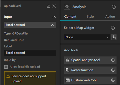

In an experience builder, I need to allow users to upload an Excel file for further processing in a notebook published as a Custom web tool.
I created a notebook, configured the input parameters with a "file" type, declared it in the notebook code and published it.
In Experience Builder, I configured the analysis widget to use the published Custom web tool.
However, when configuring the Analysis widget, the checkbox "Allow local file upload" was disabled in the input parameter for the file.

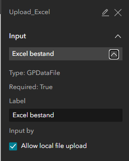

I discovered that I could edit the json service file for the web tool (webtoolService.json) using ArcGIS Assistant and allow uploads with
"capabilities": "Uploads".

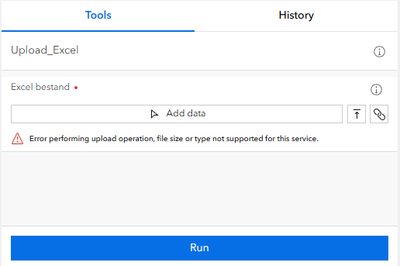

I can now enable the "Allow local file upload" option in the widget and I can click on the "upload" button then choose a local file to upload from my computer (small 1kb csv file). But when I do, I get the error:
"Error performing upload operation, file size or type not supported for this service"

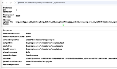

3. Can you check your web tool service's admin point see its allowing file types and max file size.
Such as "https://domainname/server/admin/services/Tooname.GPServer"

  3. https://notebooksservices3.arcgis.com/admin/services/<myToolId>.GPServer There are no properties about "Max upload file size" or "Allowed upload file types"

So allow local file upload is now enabled in Experience Builder
But I'm getting this error when selecting a small .xlsx from my local machine
