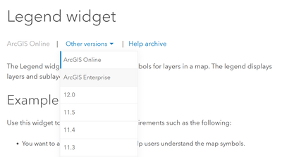

Looking at the documentation. The Respect Layer Filtering option appears in the 11.5 and 12.0 Enterprise versions, but not in ArcGIS Online which is the latest version. This suggests to me that ESRI removed that option because it wasn't working correctly.
