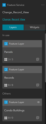

It really depends, too, on how and where the layers are being used in your Experience. If you go to the Data tab of the Experience Builder, you can see an overview of which layers of a map/service are in use, and by how many widgets.
I could have a map with 100 layers in it, but if none of those layers are used in another widget and the map is in a section with "lazy loading" enabled, I really won't see much of a hit to performance.
