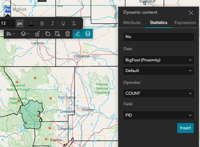

It does not appear possible using the Near Me hack to make the points filter/select without some user intervention.
If you just need some simple statistics like Count, you can use a Text Widget using Dynamic Content tied to the output of Near Me.
