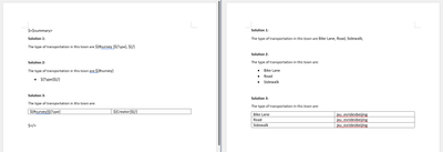

Ruth_JiatengXu
Hi @Chrystiana_chf ,
Sorry for the late reply. Here are a few solutions to achieve what you need, and I attached my template to this reply as well.
Short explanation:
  • Use $<$summary>$</> to generate summary with multiple selections from survey results
  • ${#survey }...${/} is used to print out all the selected records in the survey layer. Your layer name might be different from mine, please replace it with your layer name which can be found on the quick reference page
You can reference doc to learn more syntax: https://doc.arcgis.com/en/survey123/browser/analyze-results/featurereportqueries.htm#ESRI_SECTION1_9...
Please feel free to let me know if you have further questions.
