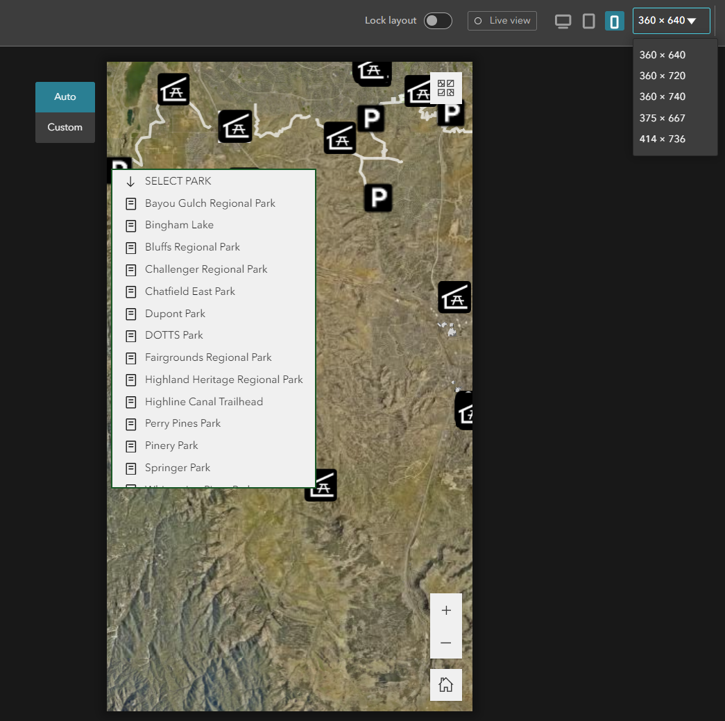

I'm having trouble with an Experience Builder map, and screen resolution on mobile devices.
It loads on my iPhone 7+ (414 x 736) but not on my iPhoneSE (375 x 568). It looks like the minimum resolution inside EB is 360 x 640, which is likely causing it to break on the smaller screen. Has anyone run into this? I found the a post that said we can specify a resolution at the map service level.   Could this be a potential solution?
Experience Builder Mobile Resolutions:

The drop-down list of sizes you're seeing is for previewing/being able to see different sizes while you're building. They don't represent the minimum/maximum size at which your experience will work (that depends on how you've set up your widgets, and of course other factors). You have even more options for previewing your experience (including iPhone SE dimensions) if you use your web browser's dev tools. Esri just gives you a selection.
