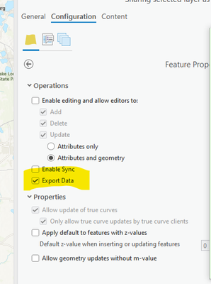

Ginger_T_Range
When your publishing a referenced layer make sure you go into the setting and select export.
