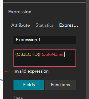

Here's the issue I'm running into.  When I try to use two fields in the expression, I get an Invalid Expression error:
If I could solve this error and use more than one field in the Expression builder, I could parse it out in the Widget.tsx file.  However, that isn't working for me so I've been trying another approach.

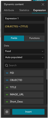

DanJiang
Hi @JohnPhillipsGeo ,
For different parts of the expressions, you need to use the "+" to combine the results into one string, something like.
