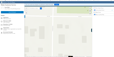

Is there a way to make every EXB automatically have the more info side panel collapsed when opening. It is one of the biggest red flags from my users, and I agree.

Hi Laura,
That screenshot looks to me like you are accessing your Experience Builder app via ArcGIS Sites/Hub. That panel is coming from your Sites/Hub application and not Experience Builder. The Site administrator will need to change the the Embedded Apps settings under the Interactions options.

It's not a widget. It's the info panel viewers see when they open

It is nothing I add to the app. I'm not at a computer so I can't get a picture right now. When you are logged in and open exb as a viewer you get a side panel with info on who created and you have to click the I in order to get that whole thing to collapse.

@ChristopherCounsell @FredericPoliart_EsriAU
This is nothing I have personally added. Here is what it looks like
All applications automatically have this. You can see it on the left side. I saw threads on this for other apps, but not EXB. You have to click the I (more info) button in order to get this to collapse.

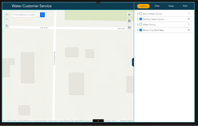

I am very familiar with the widgets and have added in collapsible side panels within my map. As you can see above here and in the editing side. But that info panel popups with information on who created it etc. for all of my users. I do not want that automatically expanded.
