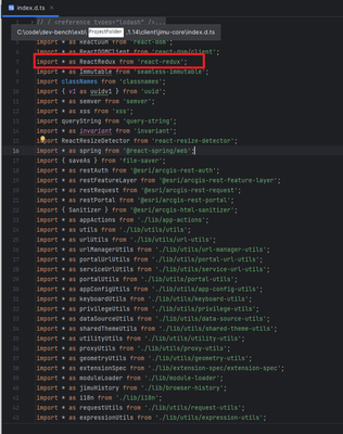

I may be wrong on this but I believe getAppStore is part of react-redux, which is bundled/imported in jimu-core:
the asterisk '*' means its importing all of it, but you won't find a react-redux folder under jimu-core

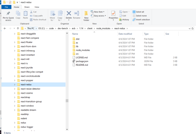

Any library that you install with npm (or that is installed by default via imports via the Exb/Jimu/Esri libraries ) but aren't written ESRI will likely be found in the node_modules folder somewhere.
of course, if you find it there, there's a possibility that library may have documentation outside of ESRI's site somewhere, so you can probably search for and find it.
