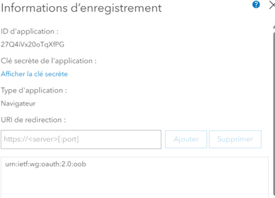

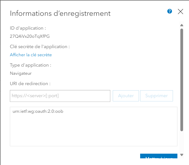

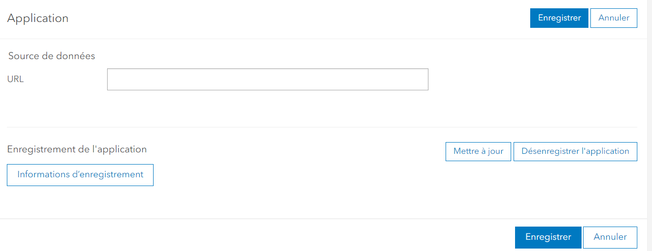

Before, i just extract the ZIP of the application on the "wwwroot", and each time i have an update, each ZIP was on another folder and I just change the URL on the application in my content. So I change the name here :
and here
So for example https://gis-portal.com/Application_1_7_2 became https://gis-portal.com/Application_1_8 (do not click on the link, there are only example).

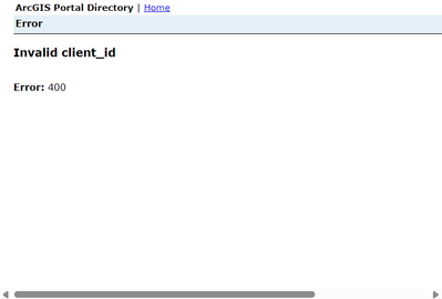

So I try to unregister the app and create another one only for this version, modifie the ClientID in the config.js files on the "Application" folder.... but this created a second problem, when people connect to the application (SSO connexion) there is the following error :
and in the link : https://gisportal.com/portal/sharing/rest/oauth2/authorize?client_id=T7XQ9XNR6D6T8S4I&
The client ID on the URL is the oldest client ID of the oldest Application that I unregister before.
