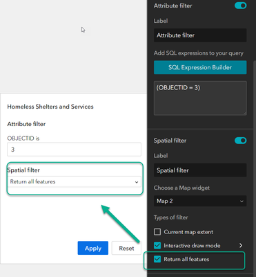

Hi @Anonymous User - you can utilize the "Return all features" for the cases where you want to filter by attribute but no spatial filter is needed:
We do not have the OR logic for attribute filter vs. spatial filter for now.
Hope it helps,
Tonghui
