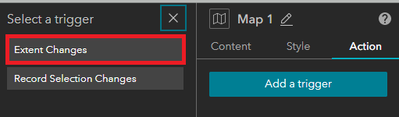

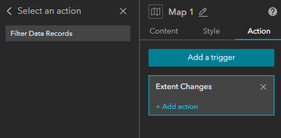

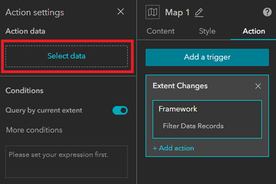

Hello,
To use the "filter by extent" mechanism correctly, you can add an "extent changes" trigger to a map targeting the framework. In the filter data records settings, select the data that is used in a table sheet. Then the sheet will be filtered as the map extent changes.

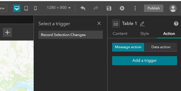

Hi @TianWen ,
Thank you for responding.
I do not have an option for the extent changes on my Experience Builder. I am using the Experience Builder Developer Edition and it is interacting with our ArcGIS Enterprise version 10.8.1. Is that extent option supposed to be there?
The weird thing is I can make one of our datasets filter by extent by setting up the Record Selection Changes, is that supposed to happen?
TianWen
Hi @RYANCARL , the extent changes trigger can be configured in the map widgets action settings rather than the table widget.
